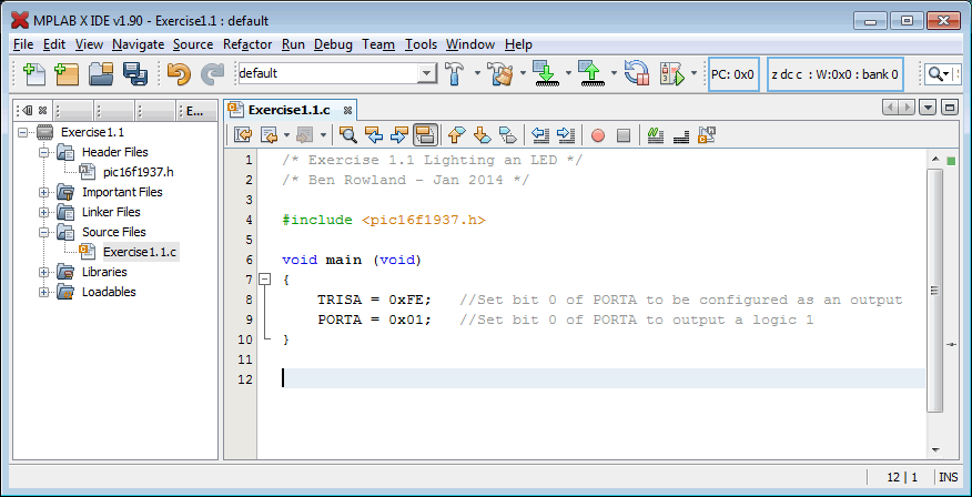

XC8 is a part of the MPLAB X IDE (Intergrated Development Environment). MPLAB X IDE provides the editing environment and manages projects containing a number of different source files, and sends them to the MPLAB XC8 compiler where you compile your program.
MPLAB X IDE is the part of the program that you will see and use, so we will normally refer to MPLAB X IDE rather than the MPLAB XC8 compiler.
The MPLAB X IDE (Click for full size image)
